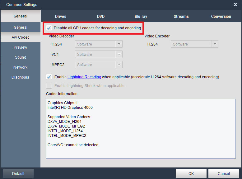

                    In v9.1.4.5, try changing the I/O mode in Common Settings->Drives->Read from Auto to SPTI or ASPI.

                            So I completely uninstalled version 9 and installed the 9.1.4.3 (beta) version from scratch.
                            When I try to 'Full Disc' copy a blu-ray title, everything starts up ok, but 2 minutes in (after 135MB copied), nothing else copies. The 'Task Time Left' keeps increasing until it eventually zero's out and the MB/s transfer rate keeps dropping towards zero. I can let it sit for hours and not see any errors. If I look at the location it is copying the files, the directory size does not get any larger.
                            I have included the internal log for this action below.
                            Other tidbits of information:
                            1. If I preview the disc, it can play the whole movie.
                            2. If a try to rip the disc, and encode it in H.264 format (PS3), it will encode about 18 minutes of the movie and then say it is successfully finished. I made sure I selected the title that was over 2 hours long, and if I repeat it, it always stops encoding at exactly the same spot.

                              Try going into common settings and disabling the GPU(s). That GTX 760 might be using an unsupported CUDA version in the driver. Give it a try, nothing to lose.
