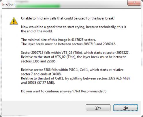

    I have a movie that I was backing up. the movie is long so comes on 2 DVDs.
    I used the Main Movie feature set to DVD5 to copy each of the disks main movies to separate folders on my HD.
    I then used the Merge feature to place both of these Main Movies on the same DVD9 Dual Layer disk.
    DVDFab processed the merge beautifully to a temp folder with limited compression. Unfortunately, once ImageBurn launched and began to burn the file to the DVD9 media, I got a strange error message telling me that it could not find any cells that could be used for the Layer Break. it went on to say that it was a "good time to cry because it was the end of the world." I could not follow the suggestions on how to fix this error so I am hoping that someone with similar experience can help to educate me.
    I have attached a screen shot of the error message. I did not post the DVDFAb log because DVDFAB appears to have performed its function properly. I can do that if needed.
    any help would be appreciated,
    Thanx
    DCE
    Click Yes and continue anyway. In most cases it will work fine, although you may notice a slight glitch or pause at the layer change during playback. I did the same thing with the DVD of Schindler's List. You can also try using the DVDFab Internal burn engine instead.
