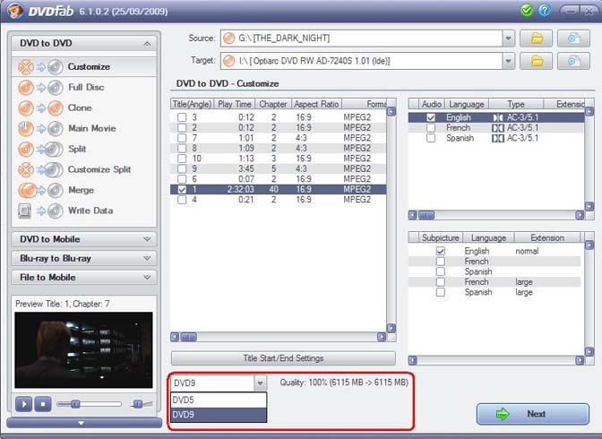

                  As Fab opens the disc, you're presented with a number of options, one of which is selecting the Target or output size.
                  Here's a screenshot:

                        Ok from what I can see the source does have the disc name and when I tried cloning it the first time and it wouldn't accept my -R disc it looks as though it copied a iso file to my documents. I am not sure what you mean by "Be certain to bitset (booktype) the blank verbatim to DVD-ROM, before you burn"?? Also from the screen shot it looks like it it's in a different mode other than clone. I stopped at 3 different stores yesterday I can't find Verbatim media... Staples and radio shack among them... Thanks for all the help thus far...

                            Been reading through the tutorial guide and almost all of the screen shots show the drop down box with the -5 -9 option. I do not see in the clone screen shot. I still need to know what
                            "Be certain to bitset (booktype) the blank verbatim to DVD-ROM, before you burn"?? means??
