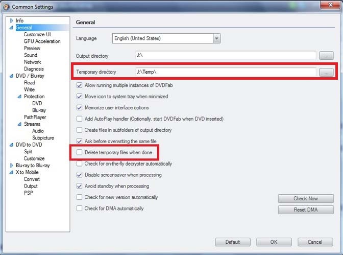

    The only folder that Fab controls in this regard is the Temporary directory.
    This default setting is ticked on, ie.,
    Delete temporary files when done
    Please see attachment:
Name:	Temp files.jpg
    You can see that my setting is unticked.
    Please check this.
    I can't imagine how else Fab deleted any files.

      My directory is D:\DVDFab\Temp\ The clearing of temp files by the application should not have deleted the DVD copies, they are (were) located in D:\DVDCopies.
      Within that folder were subfolders for each DVD copy that I had yet to Rip with DVD to mobile and a subfolder D:\DVDCopies\ripped which contained all the DVD copy folders that I had already ripped. I had used this target for about 150 DVDs.

            I now think I know what happened. In the General section of the settings there is an option to Create files in subfolders of output directory. In my 6.x install I had this option selected. On the 7.x install I did not.
