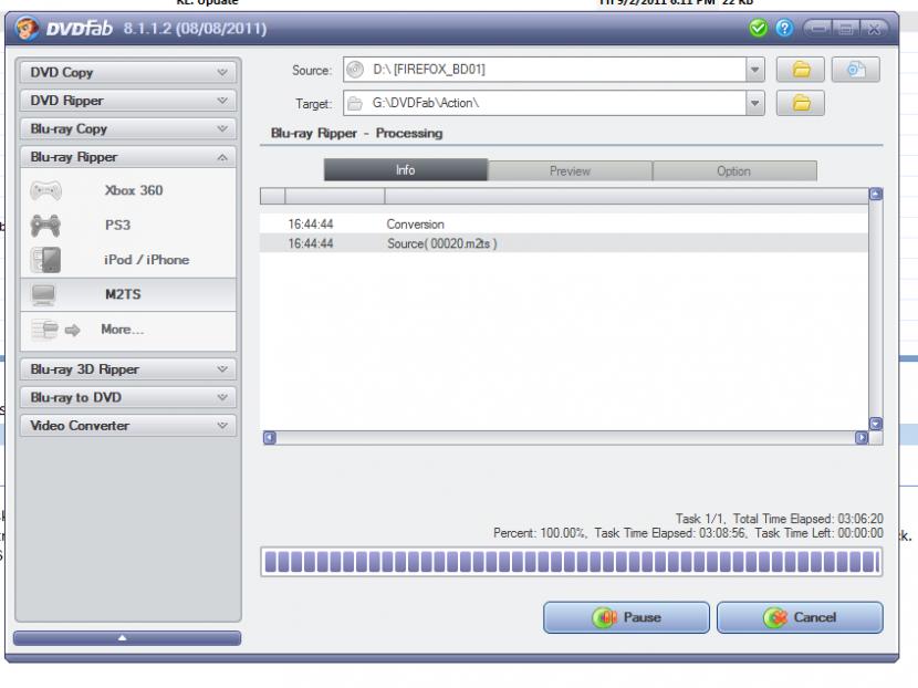

After 8.1.1.0 BD Passthrough had to be cancelled in GUI.
    BD Ripper (3D Plus) After 8.1.1.0 BD Passthrough had to be cancelled in GUI.
    While the resulting M2TS file appears to be finished and playable, the GUI in releases higher than 8.1.0.0 never sends the completed message box, the task timer shows 0, and the user must hit cancel to end the RIP session.
    After hitting cancel, and them finish, when I exit DVDFab I get a VC++ runtime error.
    This happens consistently for me on all BD discs, and I have logs and screen captures I am including that I captured ripping the movie FIREFOX.

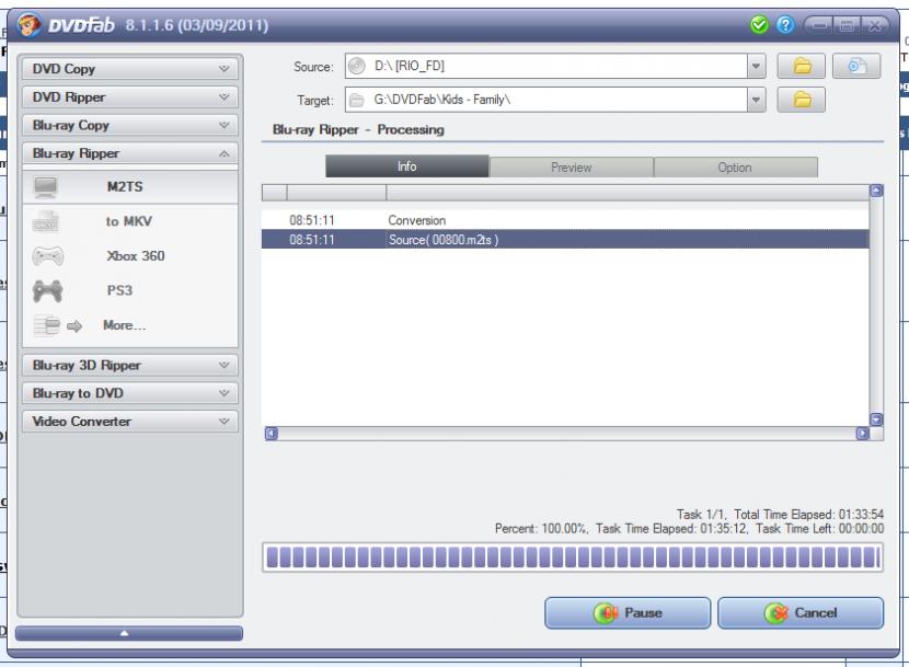

            Still hangs in 8.1.1.6 , tried a different movie, but finishes the rip never releases the GUI with the message box stating the rip was completed and needs to be cancelled to exist rip.
