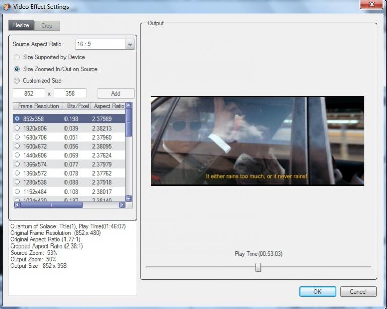

    When I open the target and select "Edit", what I see is in the first attachment.
    DVDFab wants to put it into a 2.37 aspect ratio.

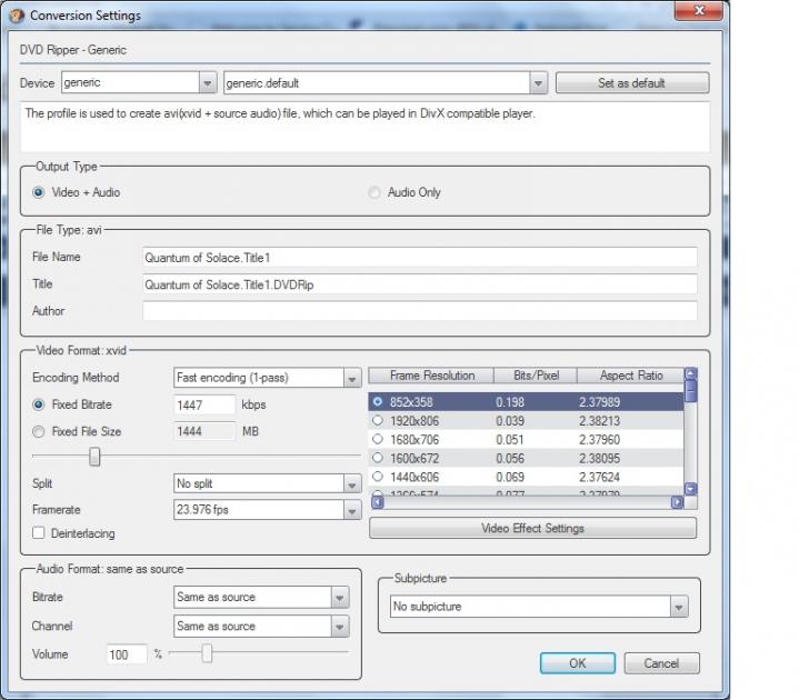

    If I go to video effect settings, (second attachment) it tries to keep it as a 2.37, even though it says that it's original aspect ratio is a 1.77. Regardless how I edit these settings (and those on the crop screen, which are set to "automatic" and "keep aspect ratio", I end up getting black bars encoded in the video.
    Even if I manually change the resolution to a known 1.77 ratio (attachment 3), it still gives me black bars.

        This is a complex subject. You should understand the fact that unless your TV is 2.35:1, all movies that are that size when decoded will have black bars top and bottom, and some (mostly older titles) may have black bars on all 4 sides. There is nothing DVDFab can do about that short of letting you manually crop the sides of the picture to turn it into 1.78:1 to match the screen on the TV. Read up on letterboxing and pillarboxing on the internet and remember that DVDFab displays the "original" aspect ratio based on the DVD's IFO files, which is not necessarily the same as the aspect ratio of the displayed picture.
        You can force DVD or Blu-ray Ripper to encode the video to any output size you want by using the Customized Size button on the Video Effect Settings page's Resize tab, entering the size and clicking Add. You can also use manual cropping (the Crop tab) by selecting it and then using the black bars slider to change the output as shown on the lower screen.
