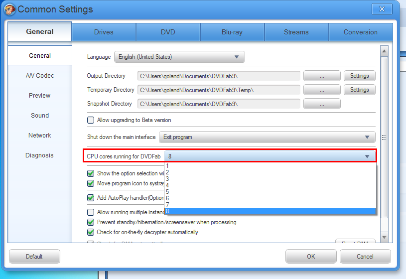

    Hi ppsych,
    What's the max CPU cores running for DVDFab in Common settings->General->General?
      Just 8, as in your example, despite 12 active threads. If you set the number of active cores less than 8, it actually uses that set (i.e. lower) number. However, there's no possibility to set higher number than 8 because DVDFab simply doesn't see them all.

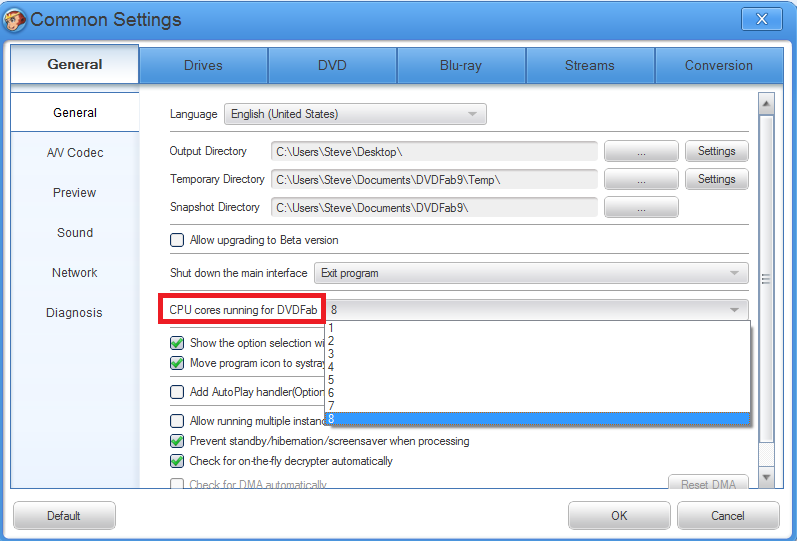

          same issue here. 3930K only shows using 8 of the 12 threads in hardware monitor. and temps confirm that 2 cores are not being used to convert - much cooler
          in the options it only goes up to 8

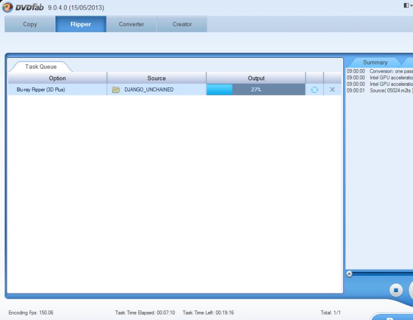

                  Paul, I have an i7 3770 and I only have 8 cores but I can almost double your speed by using the integrated graphics GPU Intel Quick Sync. This attachment is for an MKV.ac3 at full resolution for my media player:

                            I agree with signals all the cores working on your encode is a good thing, but you can select how many that DVDFab uses here:
                              Forgot about that in v9. Good catch.
