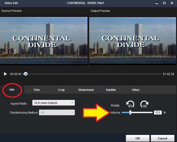

      It is inexplicably on the Info tab on the Edit page. Annoying.
        I would have never thought to look there

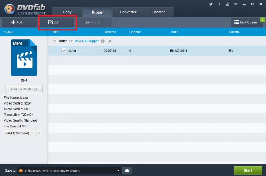

        To get to the INFO screen, after selecting the source click the EDIT button:
          Wow, would never have thought to look there.
          Of course that being said, it makes no sense to move it from right where all the other audio settings are still located.
