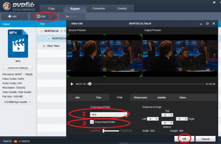

    Auto-crop seems to be broken, try setting it to 16:9 manually and put a check in the "Keep Aspect Ratio" box as shown in the capture. Looks like it is chopping pixels from the left side of the image when set to Auto. I will pass it along to the QA Team. Sorry for the problem.
