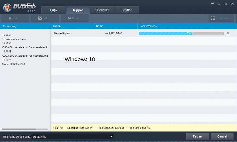

        It works on the GTX 980 with Windows 10 64bit for sure, I have another machine with GTX780Ti, that it doesnt work on though, is their a special driver to make it work?
          I just bought a EVGA 960 for another system that I am building, so I can now test, the difference between DVXA and Cuda.
            You can't check it in Fab in W10 but it does work and is marginally faster in 10x64:
              That cant be H265, it has to be H264 right.
                It's an nvidia GTX 980 card I'm using, you'd know more about what it is than me? But if it is H.264 there is no appreciable difference in operating systems.
                  I have in my labs, GTX980, GTX 960, AMD Matrix R290X, GTX780Ti. Operating systems have a big impact, W10, which I am using on all builds because in the near future it will be the OS of choice, its free, more stable and now Nvidia just has to make a driver that works with previous Geforce cards because thats what most people have. The majority of people are not like you and I and spend 500.00USD on a GPU. I find the HEVC H265 on Fab to be of excellent quality but you have to use the correct drivers and GPU, this is Nvidias fault not Fabs. Maxwell architecture is great but only is avialable in 750Ti and the 900Series.
                    The screen captures were h265, look at the fine print in the process area on the left.
                      That's what led me to believe it was working on Windows 10x64 even though it can't be checked in the A/V settings of common settings. Both are identical.

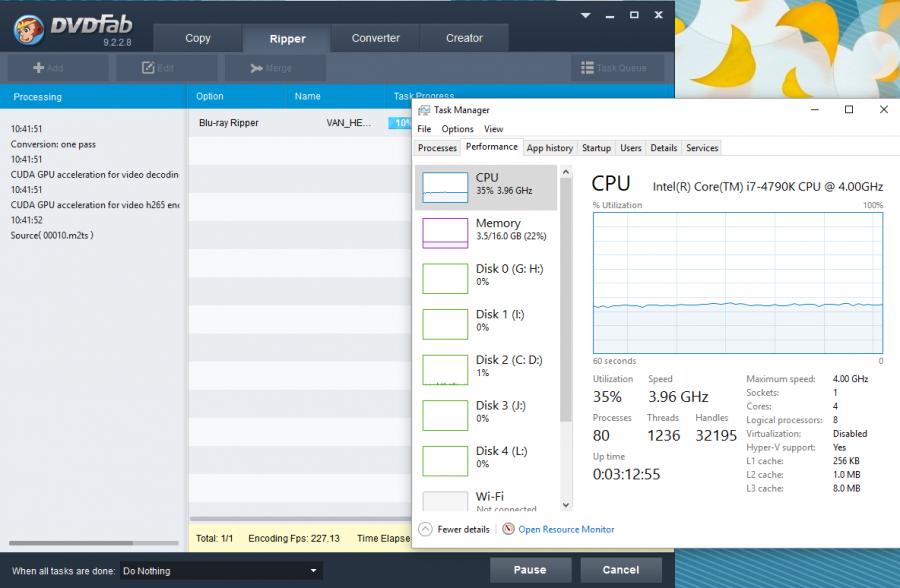

                        Are you doing this with a 980GTX, what I saw in the screen captures? I have to figure out what you are doing that I am not because you are 10 times faster than I am.
                          I'm using a BR folder on the HDD to hurry things along. An i7-4790K @ 4.0GHz so nothing special. The GPU is doing the lion's share of the heavy lifting.
                            I have been doing it from disc, I have to see if that any consequence. Thank you, we both have 980GTX cards and I have a 5960X processor, so we at least be equal in the hardware catagory. Thank you for input.
                              As you can see here the CPU is only 35% or so involved in the process Chameleon:
