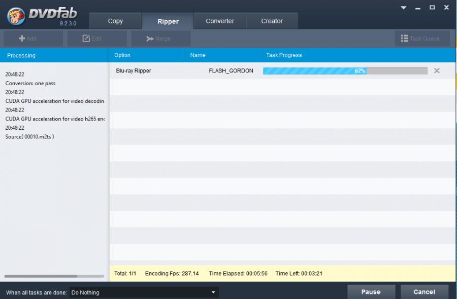

                      I don't get the message that it's encoding H.265 with the new driver?

                          That was in Windows 10 signals, all good in W7x64.
                          Update: After a reboot of Windows 10 it's all good too.
