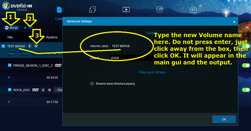

    For Merge in Copy mode, use the following steps; illustrated below:
    1. Select Copy, then Merge from the GUI controls
    2. Load the first Source by drag and drop or the "+ADD" button
    3. Load the second Source as above
    4. Configure both Sources, for titles, chapters and audio/sub streams
    5. In the top line select Advanced Settings (#3 in the capture)
    6. Type the chosen name in the Volume Label box as shown
    7. Click OK
    8. Click Start
Name:	1-011 MERGE.png
      What about the merge function inside the Ripper or the Converter module? Those are the ones that I had the problems with. I didn't try the merge function inside the Copy module.
        Here is what I'm doing. DVDFab normally starts up in the Ripper module for me, but if it isn't there I click on 1 to get there. I then click on 2 and get the titles ready I want to merge together. I then click on 3 to create the merge task. In your instructions you referred to advanced options, that they aren't here 4. I next click on 5 so I can change the name. After I'm done changing the name I have to either press <Tab> or click on another title. If I press <Enter> while trying to rename the merge will be removed as if it's never there. Should the name change stick, if you then display the task queue manager by clicking on 6 it shows the original name "Merge 1"
        What I would like to know, am I doing this incorrectly or is this a bug/installation problem?

            Darkore,
            Update about the merge problem, it's fixed in DVDFab 10089, please update to check it out.
            Regards,
            Mona
              Works like a charm. Thank You
