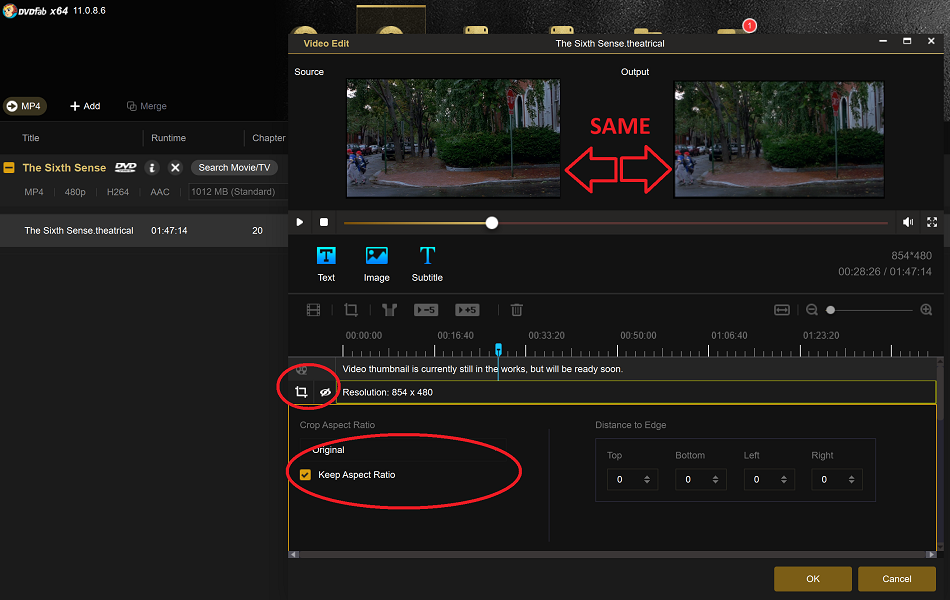

This disc works normally for me. Check the settings shown in the Ripper video editor

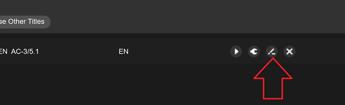

which you can access here after loading the disc
