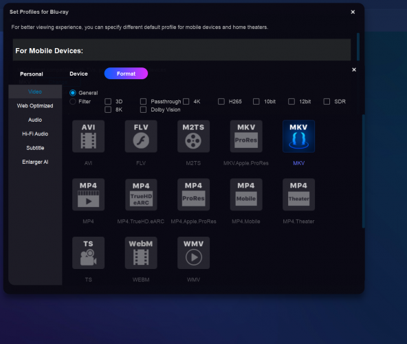

    I'll do my best by posting screen captures to explain this. IF I select an audio track from the general "Profile" tab it not only changes the audio, it changes the video to whatever the "Audio" selected.
    I've selected MKV for the audio in the Profile app/tab.
Name:	Video set to MKV.PNG

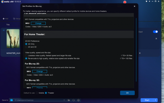

    Everything is correct.
    If I go to the AUDIO option in the Profile app/tab, thinking this is how I change JUST the Audio track. I select AC3. BUT its not just the audio that changes to AC3. The Video changes from MKV to AC3.

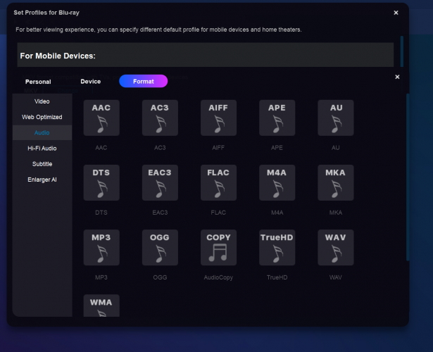

      When I click on the "Audio" tab of course takes me to this screen for Audio options. I pick AC3.
Name:	Audio Profile.PNG

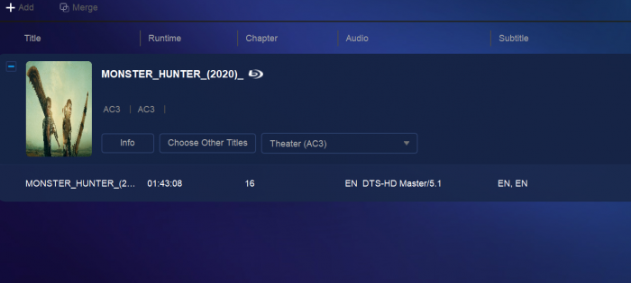

      This is what the result is. As you can see BOTH Video and AUDIO fields now say AC3.
Name:	Changes Video to AC3 as well..PNG
      As noted the one rip I attempted just to see if this was a GUI error, the Video was really MKV even though it said AC3, ripped only Audio. The GUI was correct.

        The Audio tab on that page leads to options that are all audio-only, i.e. that audio button tells Fab that is all you want in the output. If you want to change the audio bitrate or format, those controls are on the Advanced Settings page which is accessible from the button with that name which is above the title information on the Ripper main page.
          That could be a little clearer on the option screen.
            Perhaps so, but the Ripper GUI has the tricky task of being easy to use and providing a powerful and rich suite of user controls for the experienced user. This involves some trade offs on both sides but I think they have struck a good balance.
              Maybe but your explanation isn't consistent with how the rest of the options for that tab work. If you select a video codec in the "Video" section DVDFab doesn't assume you're JUST doing Video and set both Video and Audio to the Video selected option. Select MKV in Video tab DVDFab doesn't change Audio to MKV. Why would it do so in the Audio tab? If the audio option is intended for burning audio only, why does it make an MKV file?
              And it doesn't start with selecting an Audio output file. You are configuring a Bluray or DVD, UHD.
              Whether it is or not sure looks to me like a bug.
                I’m talking about the top picture in your first post. The musical notes in the icons should tell you they are all audio profiles and you are in the wrong place.

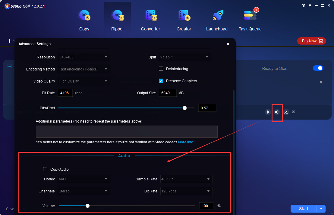

                  After you pick MKV as a profile, you can click on the wrench button to open the Advanced Settings window to select the audio codec you like. See image attached.
Name:	set audio.png
