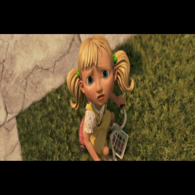

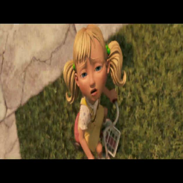

    This makes no sense. If I crop a 1:.2.40 movie to 1920x800 and then render it to 1920x1080 to get the right appect ratio? There is no change in the result!
    I have checked the croped .MKV and there are black frames in the rendered picture from DVDFab Bluray2File !
    Please see my both pictures which are taken with videolan (reduced to 50% size to upload). One picture is from the croped 1920x800 (!) and the other was from the original 1920x1080 which was provides from the bluray disk.
    You can see that the result from Bluray2File ignores the croping and makes a strange looking videofile :-(
    This must be a bug.

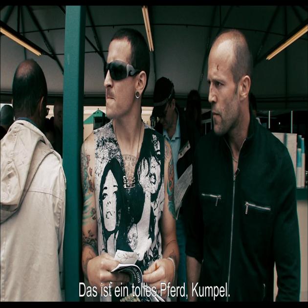

        This was I have done. I crop the file and set the output to 1920x800.
        If I then look to the result (single frame) it has black bars in every picture!
        Please see the atached picture, this is the result from a different tool which generated .mkv videos. There are no black bars in the 1920x800 picture. If I try the same with dvdfab, I have black bars in the result.
        Why?
