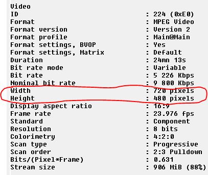

          Ting, unless I am missing something there is NO "Same As Source" option when using either the WMA9 or WMA10 WMV xBox profile. Have tried 23.97, 29.97 and others while testing. Pixelation occurs after a seek has already occurred. Start video, move forward, video pixelated, give it a minute pixelation gone. Continue play seek again, pixelation again. The more seeking the more pixelation and out of sync the video will play. Using Software in the AV Codecs. Another item is the audio has distinct "buzz" about it. Faint but there. Do not hear it in the source, only on the WMV converted file in FAB. Final item is related to the attached.
          First is the MediaInfo from the DVD VOB file, Width 720 x Height 480
          Second is the Video Effects Setting window with FAB's interpretation of the VOB file Width 852 x Height 480. This ends up creating a video with a 720 x 302 cropped resolution.
          Does this make sense? I use another app to do the same thing and the Width and Height match the VOB and create a cropped video 720 x 360 which makes more sense to me. No pixelation on seek, no out of sync issue and no buzz in the audio.

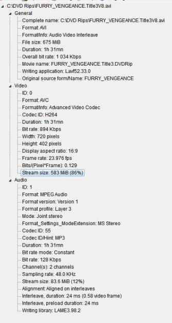

                      1. Copied movie to HDD using V8
                      2. Converted HDD file to WMV using V8 Zune profile. Mediainfo attached. File was horribly out of sync by the end of the movie.
                      3. Converted same HDD file to AVI @ 900Kbps with V8. Mediainfo attached. File sychronization was OK, but file played choppy. It didn't stutter, but the motion was definitely not smooth.

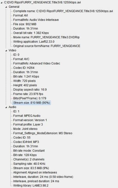

                      3. Converted same HDD file to AVI @ 1250kbps with V8 thinking it may correct the choppy video. It did not. Mediainfo attached.

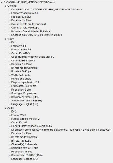

                      4. Converted same HDD file to WMV with Zune profile with V6218 and same settings as V8. The only thing I changed was this was a 2 pass conversion. Mediainfo attached. Created file had great picture and a/v sync.
