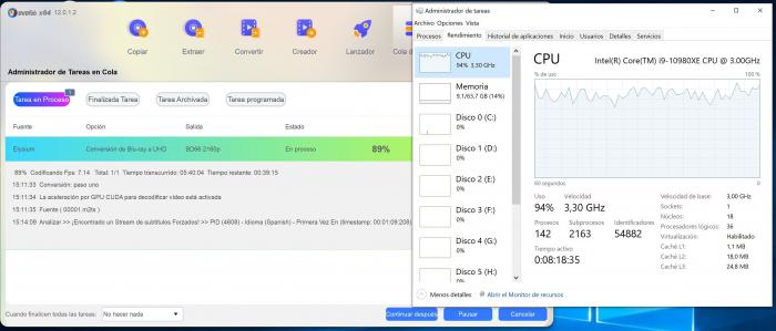

    1. Why Enlarger AI only uses the CPU in the Copy module. And only in BD to UHD template. Neither in Ripper nor in Converter my CPU works (its use falls below 10%). In the Copy module the CPU usage goes up to 90% on average (see screenshot).

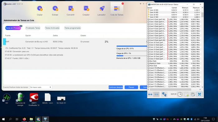

              My CPU is running at 3,3GHz all cores when I am using the BD to UHD template (HEVC). 3,3GHz is the AVX2 all cores speed of my CPU. If the CPU were using AVX-512, then the CPU frecuency should be 2,8GHz.

              As you can see in the attached picture (on the right, the HWInfo), the CPU is running at 3,3GHz all cores (most of the time) when I am using BD to UHD template. That means no AVX-512 are in use. If it was the case, then the all cores CPU speed should be 2,8GHz.
              Thanks for your time
