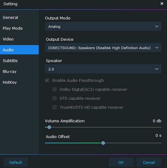

    Thanks for the feedback, we will try to duplicate the problem. In the meantime, please check your audio settings here:
    Click image for larger version  Name:	1-011 PLAYER5AUDIO_2.png Views:	1 Size:	21.2 KB ID:	346835

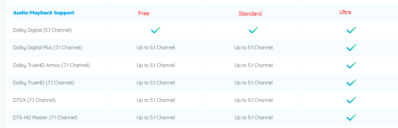

                    Just a thought:
                    Which Player 5 edition are you using? Free, Standard, or Ultra?
                    If you are using Free edition or Standard edition of Player 5, the audio playback only supports up to 5.1 Channel. Click image for larger version  Name:	audio playback support.png Views:	1 Size:	39.2 KB ID:	347673
