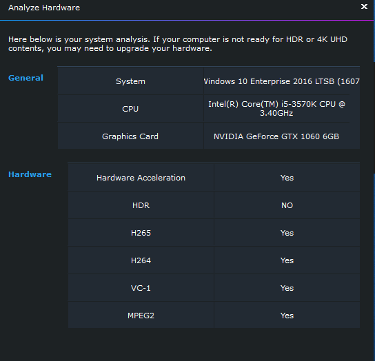

    As an update, when I click Analyze Hardware, HDR comes back as "NO". As I mentioned HDR worked under Media Player 3, and my display is definitely HDR capable. Not sure why it is not being detected.
    If logs or other files will help with troubleshooting, please let me know what to post and/or send to support.

        Please take a screenshot of the analyze result window and send it here.
        Also, please post the log files which can be found under Documents. Please see my sig for default location.

          Below is the requested screenshot of the analyze result window. The requested log file is also attached.

              As an update, in 5.0.0.4 (Ultra) Analyze Hardware now shows Nvidia instead of No for HDR.
              However HDR->SDR is still being performed by the player software (HDR is set to Auto). The native HDR metadata is NOT being passed to the TV. DVD Fab Media Player version 3 was outputting HDR metadata with my same set-up, and the TV's internal HDR on would display when playing UHD content in Player 3. Not sure why this is not working in Player 5.
