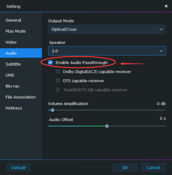

                      Originally posted by SweetOne69 View Post
                      I don't know about the Passthrough settings, I'll have to check when I get home.
                      You can find the Passthrough option in Settings>Audio. See image attached.

                        Sorry it took so long to get back to you.
                        It looks like disabling the Audio Passthrough fixes the pause problem for me.
                          Thank you for the update.
                          Please kindly check the audio type of the playback source, is it AC3 DTS TureHD DTSHD or DTS-X ATOMS? Does your receiver support to decode this type of audio?
