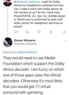

    Basically, Dolby Atmos for Headphone (DAfH) is a software that allows users to experience Dolby Atmos through any set of headphones. However, I asked the Microsoft lead audio engineer (check the screenshot below) and he says the media player itself must support the decoder for DAfH to work properly. Could the DVDFab team work on this support? Thanks.

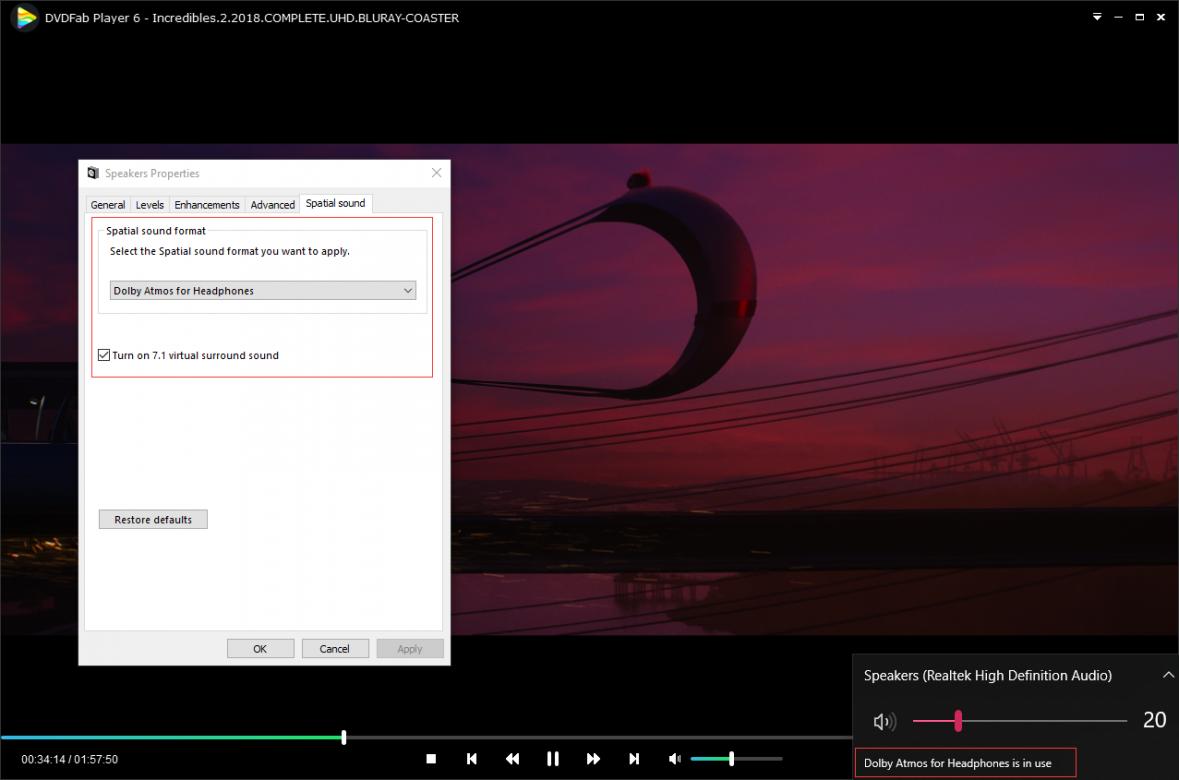

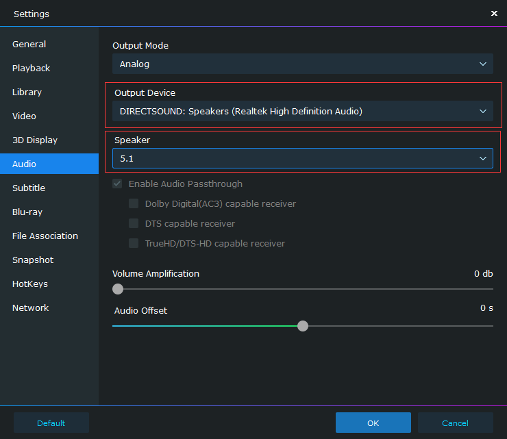

    Hi, please go to DVDFab Player 6 > Settings > audio, set "Output device" as "Speakers" and set "Speaker" as 5.1 or 7.1. So it will show "Dolby atmos for headphone is in use". See attached.

      "Dolby Atmos for headphone is in use" doesn't mean it is outputting true atmos data though. It just means dolby atmos for headphone is upmixing some signal (in this case, upmixing 7.1 from dvdfab but ignoring dolby atmos/height data). I have done some testing with a test tone file and the height channel is missing,with dvdfab. The Movies and TV app is the only media player that can decode dolby atmos/height channel but unfortunately it can only decode DD+ based dolby atmos but not TrueHD based dolby atmos (which all uhd films use)
      This is the test tone video I use: https://download.dolby.com/us/en/tes...ones_9_1_6.mp4. .Pay attention to the height channel and compare the result between dvdfab and Movies and TV app.
