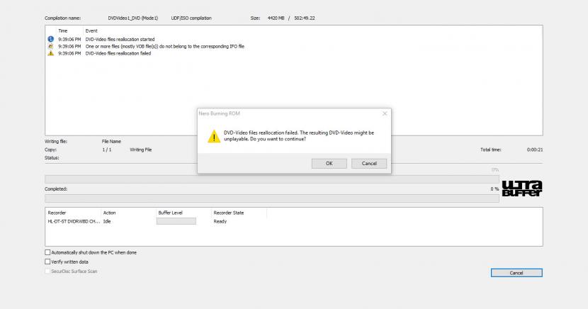

An AnyDVD user looking for an alternative. I have tried ripping several movies to hard drive using Passkey, then trying to back them up an DVD. I can never backup full movie. I have CloneDVD and DVDReBuilder which has never given me any problems. The movies are not new releases, just a couple I tried to see how Passkey would work. Both programs, when trying to backup full movie, gives me a Trying to repair defective DVD structure error. However I can back up the main movie only with no problems. Hope there is a solution. I E-Mailed support a few days ago but have not heard anything so thought I would try here. Thanks.

Maybe someone will respond eventually. Have updated to version 8.2.6.9. Ripped an older movie, Avengers Age Of Ultron to hard drive. Tried to clone movie with CloneDVD. CloneDVD gave a message saying "Trying to repair defective DVD structure" took for ever and then said it could not complete process. Tried to backup main movie only and had no problem. Tried same rip with DVDRebuilder, backing up full movie. Error stating after processing that VTS_01_0.VOB file was not present. However it will backup the main movie only.

Thanks guys for the help. As 90312 stated I think it is the menus. Basically any DVD will be problematic if you try to backup full movie.I just tried The Forrest, trying to clone the full movie gave me the error but was able to backup main movie with no problem. I dont even have to rip the movie to hard drive to get the error. I can put the DVD in, let Passkey run in the background, then open CloneDVD and try to copy that way and it says defective file structure. Thanks again.Originally posted by Rich86 View PostI have & use Passkey & it has been terrific for me. I use it mostly to back up Blu-rays. But I am game to try to assist you if possible.

I even tried to rip it to the HDD with Passkey and got read error failure. Just wait on an update I suppose.How to post the internal log
