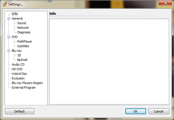

    I can manually download and install 9.2.1.3, and that works fine at first, but only for that same session of Windows. With 9.2.1.3 installed, once I reboot my computer, Passkey stops working. If I install a BD disc, Passkey doesn't recognise there's a disc present. And if I go into the INFO tab of the Settings dialogue, the data is blank. (Screen cap included.)
    HOWEVER, if I uninstall 9.2.1.3 and re-install 9.2.1.2, everything works fine again. So that's what I've done -- currently using 9.2.1.2 again. The problem seems to be with 9.2.1.3, not my system, since previous versions of Passkey work fine.

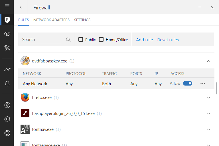

      OS is Windows 7 x64 + SP1, fully patched. My security software (Bitdefender Internet Security 2018) gives Passkey full access rights. (I just use the default settings the firewall created; screen cap of the settings is attached.) Just to confirm, I only have the one security software installed.
