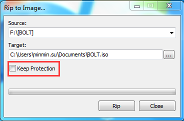

        Hi, please use Passkey to create a P-ISO image file (mark the option "Keep Protection") and send P-ISO to our FTP site to help check this problem.
Name:	keep protection.png
        Please check PM for FTP info, thanks.
