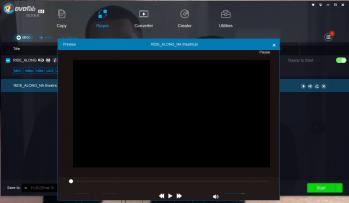

    I'm running the latest version of DVDFab 64 10.0.6.8 and the preview window no longer shows the timestamp.
    I'm wondering if this is a scaling problem on my PC or if you guys removed it altogether.
    I need the timestamp to help me verify which Subtitles to choose since I direct render them. I know at what time in the movie the subtitles happen but without being able to see the time, I can't verify if I've chosen the correct subtitle.
    Can you please let me know if I just have a scaling problem on my display and can't see the timestamp any more or if you did remove that feature.
    And if you did remove it, can you add it back.
    Thanks

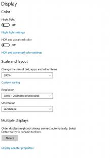

        So I found out the problem is with Windows 10 scaling.
        However, I can not fix it without your help.
        I use 225% scaling on my windows 10 pc which is connected to an 55" LG C7P Oled tv.
        With those settings, I can not see the timestamp.
        The only way I can see the timestamp is to make the scaling 100%.
        But if I do that then the font is way too small to read anything on my tv from 8ft away.
        I'm attaching a photo of the preview window with 200% scaling and you can see the very top portion of the timestamp.
        Can you please adjust the preview window properties so that I can use any scaling % that I want?
        Thank You

            Maybe you can go to "Advanced display setting > Advanced sizing of text and other items" to give "seta custom scaling level" a try and see if it will make a difference.
