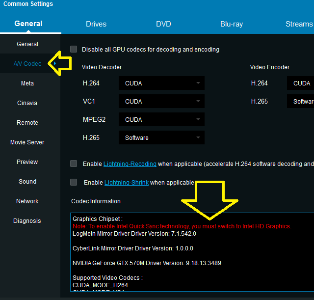

    Please copy and paste the text in the small box shown below into a text file and attach it as you did the other log. I can't duplicate this, but I am using a much older nvidia driver.
    Click image for larger version  Name:	1-011 x64GRAPHICS.png Views:	1 Size:	31.3 KB ID:	353186
