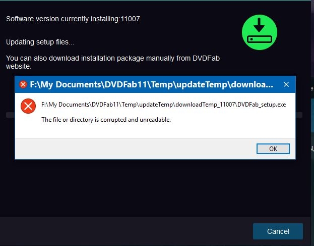

    Today when I launched DVDFab 11.0.0.5 x64, I get a pop-up telling me an update is available. When I select to update, I get the following error:
    Click image for larger version  Name:	InstallImage1.JPG Views:	1 Size:	93.9 KB ID:	362718
    However, when I click 'OK', it says it installed ok, yet when it launches again, it still shows ver. 11.0.0.5.
    When I navigate to the update temp directory, I can see several files and folders there and can open and access all folders. In the downloadTemp_11007 directory, there are two files, 'DVDFab_setup.exe and update.xml. If I manually click on the setup file, I get this same error, even if I try 'Run as Administrator'.
    When I use the offline installer, it installs just fine. I noticed when using the offline installer, it uses a different config file that appears in the update temp directory as 'update_config.xml' (slightly different file name than the update.xml when trying to install online).
    I checked my AV logs (F-Secure, provided by my ISP) and didn't see anything blocked or quarantined, so pretty sure that AV is not what is causing this. No other apps nor programs ae open when I try the online installer. I also don't think its a Windows error per se (Windows 10x64 version 1803, build 17134.441) since everything else appears to be running fine.
    I have also attached the install.log file. You can see the failed statements for the online attempt, but offline updated with no errors.
    Any clue as to what is causing online update to fail?
    Thank you.

              Nope. Checked all that and I just tried installing the 11.0.0.8 update using online installer and had the same problem. So I once again used the offline installer. I also have DVDFab installed on another computer, running the October 2018 (version 1809) of Windows. Main PC still only has 1803. Main PC running F-Secure AV, and secondary PC running just Windows Defender and get SAME error on that PC as well! Unlike the offline version, there is no way to check the checksum on the online installer. As long as they continue to make the offline installer available, I will be ok.
