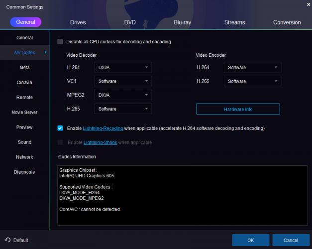

    Navigating through the DVDFab options, I do not see that for the Intel UHD Graphics 605 GPU the application supports hardware encoding. I'm missing something or DVDFab is not ready to encode with this GPU using Intel Quick Sync.
    I attach DVDFab captures where it can be seen that with this GPU it seems that Intel Quick Sync can not be activated, even though this GPU has a HEVC (H.265) hardware encoder.
    I am using Intel UHD Graphics drivers 25.20.100.6618 and its the only GPU in the system.
    Thanks.

                  Hi, I have already tested it and it works with H264, thanks!!
                  But it is only possible to encode by software with H265 although this GPU supposedly has a hardware encoder HEVC (H.265).
                  I attach DVDFab captures with the modified fabcheck.exe:

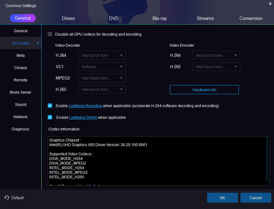

                    Please give this version a try and feedback:

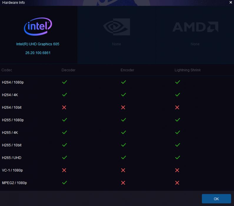

                      Hi, I have already tested the dev version and it works with H264 and also with H265, thanks so much!!!. Please, include the modifications in the production version.
                      I attach DVDFab captures that show the support of the hardware encoder HEVC (H.265):
