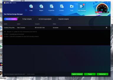

    here is the missing Screenshot

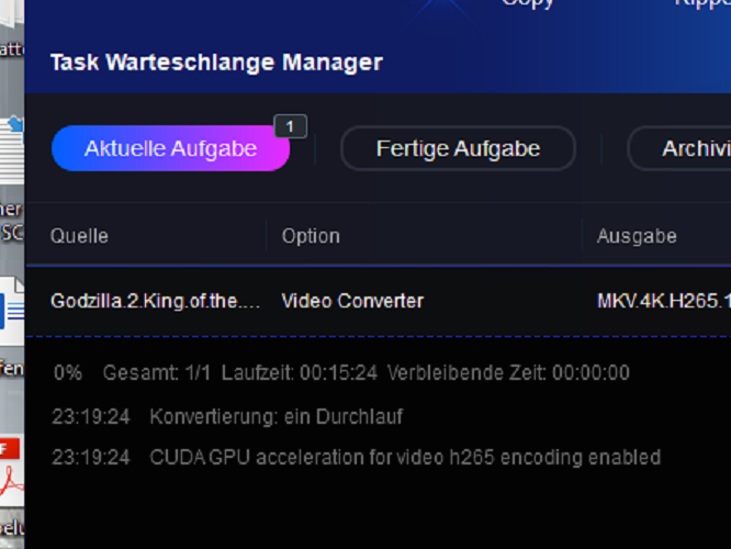

          You will see on the Screenshot the Time is running. But no Frames running.
          I do not use a disk as a source. My source is a MKV file. I want to reduce this source because 50GB is too much for me personally. Therefore, I remove all unnecessary audio tracks.
          I took the same source in version 10.xxx and it works. But in version 11.xxx nothing happens except that the time is running.
          I have this problem ONLY with 4K. With HD movies, the version 11.xxx works without problems.
