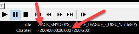

    I posted the output from the MediaInfo program already, above on July 6th. In version 12 it's posting 200 chapters all with 00:00:00:000 timestamps, but not actually preserving the correct chapters. Both DVDFab 10 and 11 work.

        I typically don't use passthrough as I have my own criteria I use so I ran one through passthrough to check and same issue arises. You can see it has 200 chapters, and it's on 200 of 200 and that it has that 00:00:00:000 timestamp. It's so irritating that I can do it in 11 just fine. I even updated 12 before doing so this morning.

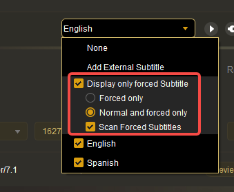

                      To confirm:
                      which options did you choose?
                        #26
                        To confirm:
                        Hey Mona, I choose exactly as you have it shown in your image.
