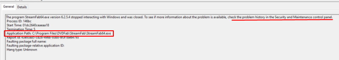

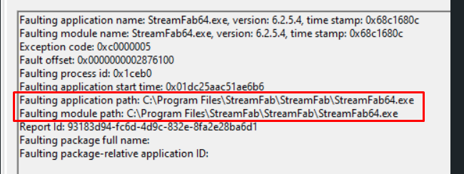

      But anyway, I will point out what I see from the event viewer screenshots.
      It seems streamfab is installed or at least trying to run in 2 locations. Program Files\streamfab\streamfab and Program Files\dvdfab\streamfab\
      Click image for larger version  Name:	GCrM-MyrT0SvOHRNzJY8HA.png Views:	0 Size:	65.1 KB ID:	468166
      Click image for larger version  Name:	qbkPmB4-TKeAO5MmoIhDOQ.png Views:	0 Size:	81.6 KB ID:	468167
        #18
        Originally posted by Stan001 View Post
        The OP was told that in post # 12 and said they would try. I think they have more of an issue than we could even imagine.
        They also do say they have done uninstalls with Revo uninstaller.
        And this is my beef with NO support from streamfab. With the constant increase in prices and added charges, they need REAL support people here.
        These events were from 2 different install / run attempts. I've tried leaving default location and I've tried using custom path c:\program files\streamfab. Yes I have followed the "guide" on clean uninstall / install.

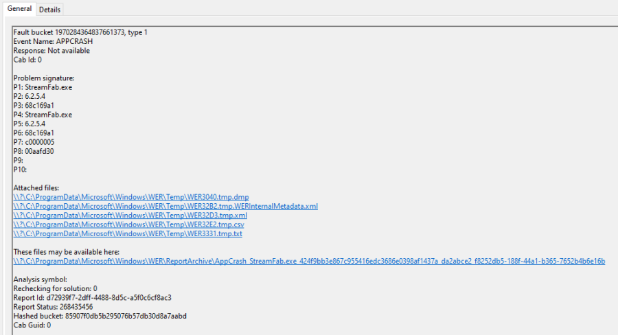

                          Tried 32 bit after full clean uninstall. It installed, but launching will not launch unless I do as admin. When launched as admin it opens splash screen then crashes with the SF crash reporter popping up.
