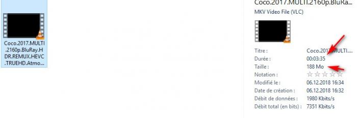

      In fact the conversion or the rip start and end successfully, but the .mkv file is not complete.
      Logs and printscreen attached.

        Printscreen of the "succesfully" converted file
          Sorry you have had a problem with this, please scan the source (original) file with MediaInfo (free) and attach the text output to a post.
