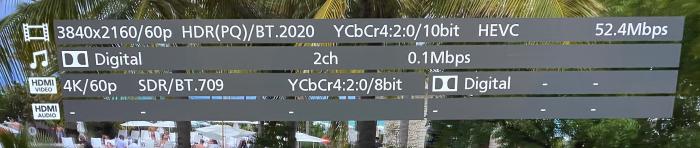

          Here's what the player says on screen, to confirm what I wrote above:
            Not only does it seem to convert to 60fps, it also looks like it outputs 10bits??? The original is clearly 8 bits.
