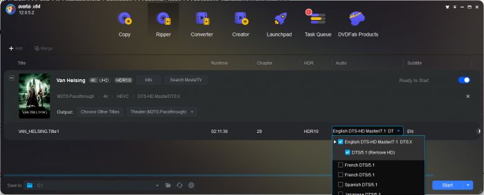

    I just discovered a bug on DVDFab 12 version, when using UHD Ripper in passthrough mode for DTS:X MA or DTS-HD MA audio, if you want to retain the DTS 5.1 audio, you must select DTS/5.1 (Remove HD) below as in picture while with version 11 this error is not encountered.
    In version 11, no need to select DTS/5.1 (Remove HD) DVDFab will automatically retain DTS 5.1 audio.

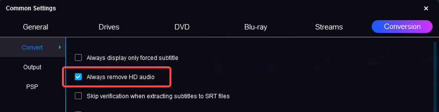

      In DVDFab 12, please go to the "Common Settings > Conversion > Convert" to tick the option "Always remove HD audio" to try again.

        It doesn't work, that error still appears
          The error here meant that you need to manually select DTS/5.1 (Remove HD) option, correct?
          Once I have ticked the "Always remove HD audio" option in "Common Settings > Conversion", I do not have to tick that option manually. Maybe you can uninstall and then install the latest 12.0.5.2 to have a try?
            As I understand "select DTS/5.1 (Remove HD) option" meant if you don't tick that option DVDFab will retain DTS 5.1 audio with DTS-HD MA or DTS:X MA above.
            But now need to tick that option if you want retain DTS 5.1 audio with DTS-HD MA or DTS:X MA above.
            For Atmos audio, don't tick that option DVDFab will automatically retain AC-3 5.1 audio with Atmos above and vice versa.

            I don't need to compress blu-ray discs, I'm only interested in remux blu-ray.
              In Passthrough conversion, when you tick the option "DTS/5.1 (Remove HD) ", the output file will contain a DTS 5.1 audio with DTS-HD MA or DTS:X MA above, which means it will output 2 audio tracks.
              If you do not tick this option, only DTS-HD MA or DTS:X MA audio will be output in the file.
