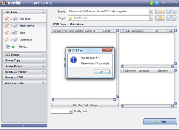

    Originally posted by W&B View Post
    If it's just that particular computer then you have some other software that's interfering with Fab. How are you dragging and dropping the dvd folder from windows explorer to your desktop? Something is missing here indeed...Fab alone won't allow that, is passkey also installed on that rig?
    Well kiss my @#!! just tried this and apparently it will, so much for my theory...
      #17
      I dragged and droped the folder onto the desktop using Windows Explorer. FWIW, the DVD was unprotected. It worked fine. It was playable from the DVD, from the folder on the desktop and I could drop it into DVDFab from the desktop, but not directly from the DVD. That gave an error asking to ensure the disk was playable. I got the same error even while the disk was actually playing.
      I do not know what passkey is and I'm sure it's not installed.
      There is no other burning software installed except for ImgBurn which BTW, has no problem ripping the DVD, detecting the type of media, etc.
      I have VLC and PowerDVD installed for playing DVDs. No other DVD software.
        #18
        drag and drop disc from Windows Explore
        Hi all,
        DVDFab won't allow to drag and drop the DVD folder (Video_TS) directly from DVD drive (windows explore) to DVDFab main screen, you will get this message "Fail to open, please check if it is playable". See the attachment.
        If you drag from windows explorer to your desktop, that is okay.
