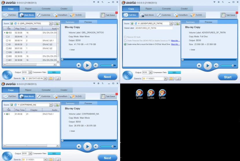

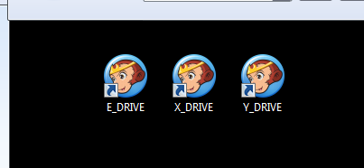

        Hey greebo, look at the attached screen capture. It shows DVDfab set up with three instances, each with its own desktop icon, that only look at one drive each. Maybe you and lakemirror should spend a little more time learning to use the product before you criticize it.

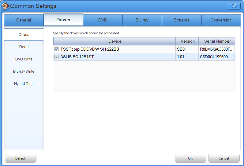

          Mind telling us how you accomplished that? I looked at all the options and did not see anything that would allow us to limit dvdfab to a specific dvd drive.
            Go here and and exclude all drives but the one you want for that install:
              I can't get that to work very well. I opened DVDFab 9 and deselected both drives in the Drives tab, then saved and exited the program. Then I started another instance, went to Drive and selected just one of the drives. It gave me the message "Must restart dvdfab", which it did and then read the disk that is in the selected drive. After that finished reading I created a second instance of DVDFab, which also tried to read the same drive as the first instance.

                For the test I made, I used a standalone install of DVDFab for each drive. Put each one in a different folder so the Settings for drive preferences can be saved individually. It took like 5 minutes to set up, longer than that to clean it up and get back to normal. If you need a step-by-step, I can lay it out. I named the folders after the drives letters, E:, X: and Y:.
                  Thanks for the info. I think I have it working pretty well now -- I just had to install another instance into another folder then uncheck the option to auto run dvdfab when I insert a disk. Now each instance of dvdfab has it's own Drive set the way I want them.
