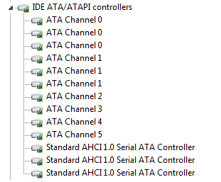

                        Additional info for that problem:
                        1. problem re-occurred on my Setup so went back to the drawing board...;
                        2. found out it was related again with some Intel Chipset file tied to the Disks on the PC;
                        Possible solution for you:
                        I went to the Device Manager and looked at the IDE ATA/ATAPI controllers listed there: there were a number of ATA Channel from 0 to 5. Did not touch that. There was also Standard AHCI1.0 Serial ATA Controller 3 times plus Intel Chipset 9 blabla (can't remember the exact wording).
                        Here is the important thing:
                        I deleted the Intel Chipset 9 blabla, rebooted a few times for Win7 to re-recognize the HDD/SDD's and install a new Controller file: Serial ATA Controller.
                        So under IDE ATA/ATAPI controllers, I now have:
                        ATA Channel 0 (3), ATA Channel 1 (3), ATA Channel 3 (1), ATA Channel 4 (1), ATA Channel 5 (1),
                        Standard AHCI1.0 Serial ATA Controller (3 times).
                        There is no Intel Chipset mention in there and did a number of refresh of the PC to verify that Windows will not re-install it...
                        The beauty of the thing is that DVDFab works flawlessly and that my hotplug for Sata drivers works so much better than before (no more delays).
                        I should mention that the MB is an ASUS VII Maximus Formula.
                        I hope this might be useful to someone else also.
                        Cheers,
                        Pierre
