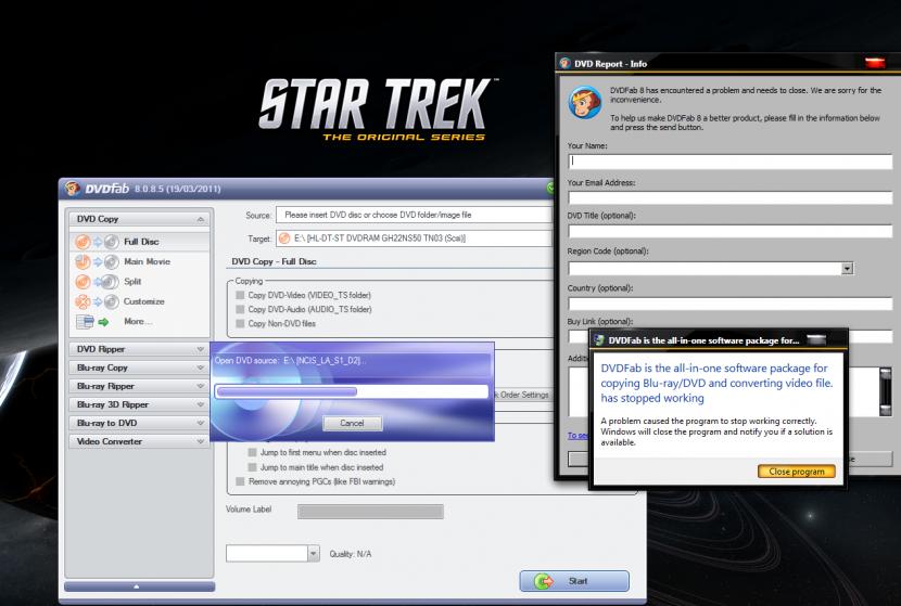

      I wish I could Here is my screen shot... As I can't not get dvdfab to get beyond this screen, with this dvd..

        If you have not done so, fill in and submit the crash report that I see behind the dialog box on your desktop.
          You should be able to click Cancel as soon as the it pops up scanning box then use the send/save info function. Fab doesn't have to open the dvd to send the info files I'm almost positive.

              In this case (with v8.0.8.5) that would probably work, but be aware that the Qt versions often crash when cancelling the opening scan of a DVD. Some of the Info files will be missing if the scan is not completed, but the IFO files and some other data will be sent, better than nothing for sure.
              I would suggest putting DVDFab in "low stress mode": in Common Settings, 1) turn off the read ahead cache 2) turn off auto-start and auto-open of the Preview window and 3) as a last resort, turn off PathPlayer. This must be done with no disc(s) in the optical drive(s).
