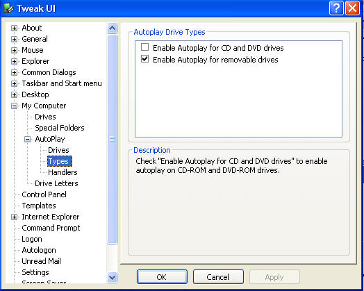

                    #24
                    @DC
                    When I wrote "Tweak UI form .... My Computer > AutPlay > Drives and de-selecting my Reader/Burner" in post # 21 I was speaking of and using Tweak, I've had tweak installed on my main box for years to stop unwanted exe's/processes from running a muck .
                    It's version 2.10.0.0, need to go see what the latest is and DL.
                    I looked on the left a couple of times and didn't see Autorun, just AutoPlay.
                    EDIT: Oops, forgot attachment ....
                    AX

                        #26
                        Originally posted by AlienX69 View Post
                        @DC
                        From the pic re your attachment to this post, go down one more line to 'Type', and you'll find a checkable box that'll allow the disabling of autorun, and that's what I was referring to.
                        I realize it's probably not a big deal to stop and restart Fab to get past the first DVD, but there is also the OP you were responding to (iwords) that may find it a big deal, and I think autorun must be disabled for the reset to work properly in Fab.
                        If I'm wrong on this point, I stand to be corrected...but I think your statements, as well as iwords, support that conclusion.
                        Please advise.
                        DC

                          I have quite a bit to catch up on, so it might take to the end of today or tomorrow at the latest to test thoroughly after turning autorun off via tweakui
                          I will advise ...
                          EDIT: I just checked tweakui, see attached, already had the CD and DVD drives unchecked. Apparently that is where I turned it off originally a very long time ago. Only thing I did yesterday was to uncheck D in the "Drives" section. I will test again thoroughly tomorrow as I'm picking some NEW stuff.
