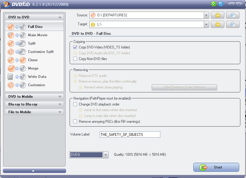

              Changing to SPTI made no difference, see attached:
              Departures was the first extraction, then I inserted "THE_SAFETY_OF_OBJECTS". As you can see the "Volume Label field updated but the "Source" field stayed the same.
