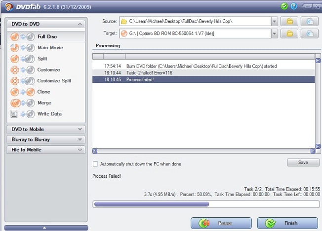

    Hi guys, I have the same problem as a poster a few threads down, and I read his post but did not feel satisfied with the solution (buying verbatim discs), because I bought a 50-pack of Amazon Basic dual layer DVDs, and have already successfully ripped about 30 of them. However, the last 5 I have attempted to rip have failed due to Error 116. I have tried ripping 3 different movies, and usually what I do is rip the movie to my HD first, and then from there, I rip it to the DVD.
    I attached an image of a .jpg file of the program when the error happened last ... I was originally running a previous verison (I think 6.0.something, but I updated to the newest version, 6.2.1.8, for this last time, and it still did not work).
    Thanks for any feedback in advance.

      It gives the error message during the burning process (from the HD to the DVD) ... it seems like when it is going from the first layer to the second layer, but I am not knowledgeable enough about that stuff to know ... I did attach the picture of the program as I did not know about the logs, but here they are:
      dvdfab_process.log
      17:54:14: Burn DVD folder (C:\Users\Michael\Desktop\FullDisc\Beverly Hills Cop\) started
      18:10:44: Task_2 failed! Error=116
      do you need any of the other ones or just this one?

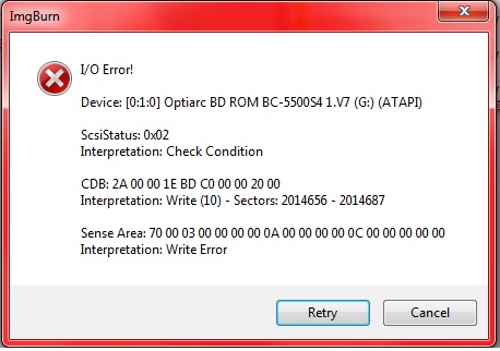

                          Post the ImgBurnh log from the one that did not work. Could be the drive or the media.
                            I 14:29:58 ImgBurn Version 2.5.0.0 started!
                            I 14:29:58 Microsoft Windows 7 Home Premium x64 Edition (6.1, Build 7600)

                            W 14:44:29 Failed to Write Sectors 2014656 - 2014687 - Reason: Write Error
                            W 14:44:29 Retrying (1 of 20)...
                            W 14:44:29 Retry Failed - Reason: Write Error
                            W 14:44:29 Retrying (2 of 20)...
                            W 14:44:29 Retrying (3 of 20)...
                            W 14:44:29 Retrying (4 of 20)...
                            W 14:44:30 Retry Failed - Reason: Write Error
                            W 14:44:30 Retrying (5 of 20)...
                            W 14:44:30 Retrying (6 of 20)...
                            W 14:44:30 Retrying (7 of 20)...
                            W 14:44:30 Retrying (8 of 20)...
                            W 14:44:30 Retrying (9 of 20)...
                            W 14:44:30 Retrying (10 of 20)...
                            W 14:44:30 Retrying (11 of 20)...
                            W 14:44:30 Retrying (12 of 20)...
                            W 14:44:30 Retrying (13 of 20)...
                            W 14:44:30 Retrying (14 of 20)...
                            W 14:44:30 Retrying (15 of 20)...
                            W 14:44:30 Retrying (16 of 20)...
                            W 14:44:30 Retrying (17 of 20)...
                            W 14:44:30 Retrying (18 of 20)...
                            W 14:44:31 Retrying (19 of 20)...
                            W 14:44:31 Retry Failed - Reason: Write Error
                            W 14:44:31 Retrying (20 of 20)...
                            W 14:44:43 Retrying (21)...
                            W 14:44:43 Retry Failed - Reason: Write Error
                            W 14:44:44 Retrying (22)...
                            W 14:44:44 Retry Failed - Reason: Write Error
                            E 14:44:51 Failed to Write Sectors 2014656 - 2014687 - Reason: Write Error
                            I 14:44:51 Synchronising Cache...
                            I 14:45:00 Closing Track...
                            W 14:45:00 Close Track Failed! - Reason: Write Error
                            W 14:45:00 Retrying (1 of 3)...
                            W 14:45:00 Retry Failed - Reason: Write Error
                            W 14:45:00 Retrying (2 of 3)...
                            W 14:45:01 Retrying (3 of 3)...
                            W 14:45:01 Retry Failed - Reason: Write Error
                            E 14:45:03 Close Track Failed! - Reason: Write Error
                            I 14:45:03 Finalising Disc...
                            W 14:45:03 Finalise Disc Failed! - Reason: Session Fixation Error - Incomplete Track in Session
                            W 14:45:03 Retrying (1 of 3)...
                            W 14:45:03 Retry Failed - Reason: Session Fixation Error - Incomplete Track in Session
                            W 14:45:03 Retrying (2 of 3)...
                            W 14:45:03 Retrying (3 of 3)...
                            E 14:45:04 Failed to Write Image!
                            I 14:45:08 Exporting Graph Data...

                              Here is the error message that popped up as well (I attached a picture of it).
