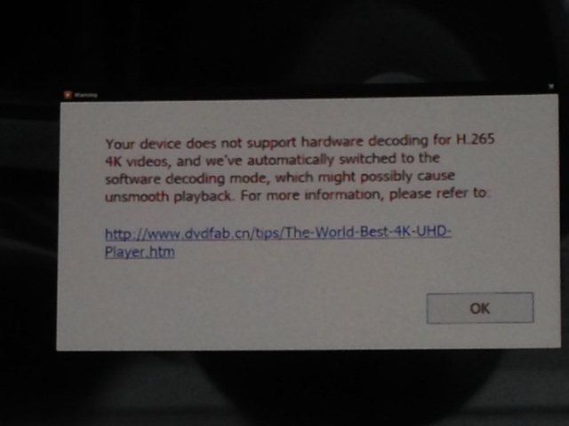

                          Hi, I installed the latest version and I'm still getting the error. So here is the screenshot. I hope you can provide some feedback.Click image for larger version

                            Here is a better picture of the "Analyze Hardware"
                              Hello AEK,
                              The picture is too small, please try again. Thank you.
