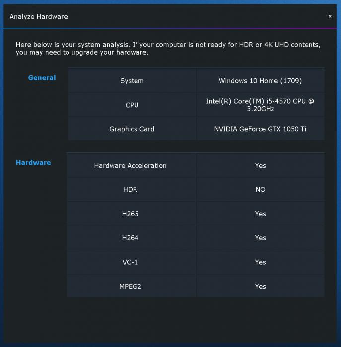

          Thanks for the answer, but it leads to the next question: The GTX 1050 is definitely a Pascal GTX1000 series card, but Player 5 signals HDR as not supported.
Name:	Player 5 Hardware.PNG
          See attachment when displayed on the PC screen.. When done on the NVIDIA attached screen only VC-1 is additionally supported.

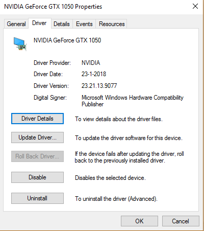

Name:	Driver version.PNG
            See attached display for the driver. No newer version found, it is also very recent just 2 weeks old.

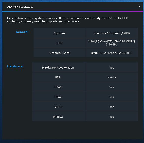

                hi,
                please check the hdmi is good and connect to gtx1050. and if possible please try update win 10 OS to new version. then give a try.
                and pleased attach your log file. thanks
                  No HDR, but my UHD monitor is not HDR-capable.
                    Connected to the UHD OLED TV, works as expected.
                      I am waiting for a brand-new HQ 5m long HDMI capable supporting HDMI 2.0a+ as it states (should arrive soon). Will use it to connect to my OLED TV with HDR and redo the test.
                        I am getting now the same results as gorba8.9 which leads me to the following conclusions:
                        - The GTX 1050 card is supported and may be taken as the minimum GTX 1000 card level for HDR.
                        - In contrary to the other Hardware tests HDR can only validated if also a HDR capable Monitor/TV is attached during that test. I recommend changing the text just above the "Analyse Hardware" button including this.
