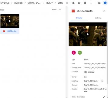

          Hope this is what you asked for...
          https://drive.google.com/drive/folders/1ZhNXaoIha-FIDt_eUdFG4zE_E92irzCc?usp=sharing
          Just to be sure that we're on the same track.
          The disc contains 3 titles numbered: 803, 804 and 805, where 804 is the one failing. And is the one being shown at top when selecting titles.
          So, it's the one I have worked with.

            I have downloaded the file, but there I don't see the problematic title copy, there is no STREAM/m2ts files under the folder you uploaded.
            Can you playback the title copy without problem on your side?
              I'm not sure I understand you.
              When I follow the link I provided, I see a 10GB "00050.mts" file.
              So, what are you looking for/do I miss ?
              I can play the .mts file with VLC, but I cannot rip it with render.
              Also I cannot play it with Windows Media Player - that is: I can play it, but there is no sound nor subtitles.

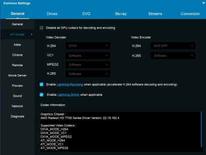

                    We will need to run more tests, meanwhile, please go to Common Settings>General>A/V Codec, tick the "Disable all GPU codecs for decoding and encoding" box to convert again on your side and see if it will make a difference.
                    Regards,
                    Mona
                      Yes, that seems to work, although taking quite a bit longer time.

                          Anyway, I have been experimenting a little with the GPU settings shown in the attachement.
                          And with the shown setting only 1 out of 10 fails. And a factor 3-4 increase in speed.
                          Have you been able to reproduce?
