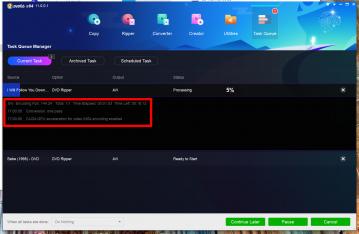

    Just some observations made on the new user interface. Figure 1 is what I see when I start ripping two discs.

    After the first disc is ripped it ejects that disc and moves onto the next. Figure 2 is what I see when it moves on to that second disc. In section 1 the task queue buttons disappear. Section 2 it never displays info like it does for the first disc. Section 3 the task queue buttons disappear in this section as well.

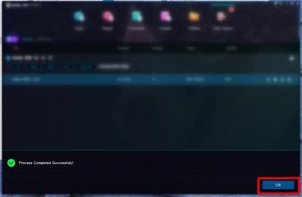

    Figure 3 after the rip is done it displays okay button. When you click it the task queue is erased, and you can never check the info on the individual titles to see if there are forced subtitles for instance. Also it would be nice if you are returned to the Ripper module when done see you don't have to reselect it every time.

    Good points, especially about returning to the selected mode when finished. There have been some other mode selection issues reported, it is all being checked.

      The second DVD was Showing, it was everything else that was not showing, IE: the Progress Bar, the Progress Log and the Frame Rate. The only thing showing during the rip of the second DVD is the "Percentage Done" on the right hand side.
      Everything was Exactly the same as showing in the images in the above post by Darkore

        I figured out how to get all the information back on the screen, click on the tools button and then click on the task queue button. It forces it to refresh the window, after it refreshes all the information displays properly
          It will be fixed in next version.
