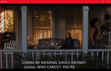

        Well, I tried the "Extract Original Format" method but that did not work. Not sure why it is working for Germania​ and not for me:
        (Note that the vtt file for this subtitle reads as follows:
        26
        00:00:38.956 --> 00:00:42.001 position:19.52%,start align:start size:67.14% line:84.62%
        <c.white><c.mono_sans>GONNA BE WEARING SHOES ANYWAY!</c.mono_sans></c.white>
        27
        00:00:38.956 --> 00:00:42.001 position:21.43%,start align:start size:61.43% line:79.29%
        <c.white><c.mono_sans>Lorelai: WHO CARES?! YOU'RE</c.mono_sans></c.white>
        which would explain the placement on the video, but based on the audio the two lines should be reversed, and they are correct if I just watch the video directly on Netflix without downloading.
        The image below shows what I see when watching after downloading using the "Extract Original Format" method
          26
          I converted original vtt with (portable) SubtitleEdit to srt
          via context menu: SubtitleEdit.exe /convert "%1" srt
          Both lines have same time stamp ..
          .. but also vlc is showing correct:

              Yes, all the problems with these subtitles are when multiple text lines have the same time stamp, but the first one is the one that should be the last. It is interesting that in your case, the subtitles got put back together properly even though the wrong one is listed first. Wonder if that is the case with the other one I mentioned at about the 20 second mark. Also, curious if you did not convert to srt would the subtitles be in the right order. In my case using the vtt file directly the text is in the wrong order.
                  I don't convert to srt because I generally watch these videos with Kodi which (unlike a number of others) readily reads vtt.
                  Original vtt (and converted to srt) works fine with mpc-hc (my default)
                  and of course the same with mpc-be - also successfully tested with vlc.
                  So it must be a Kodi problem.​
                      I use Kodi for EVERYTHING i play. Even when watching on my phone with my Viture Luma Pro (which are amazing on a long plane trip BTW)
                      Maybe has something to do with the fact that i strip all formatting and positioning from all subtitles...
                        I can't say how Kodi behaves when two subtitle texts have the same time stamps ..
                        .. the fact is that all of my installed players display it correctly.​
