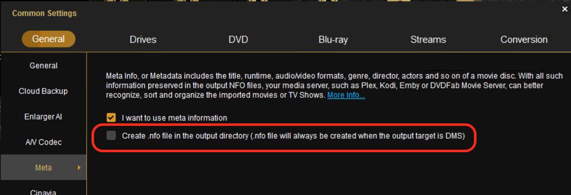

                  The option to not create NFO files is in Common Settings > General > Meta section.
Name:	disable NFO .png
