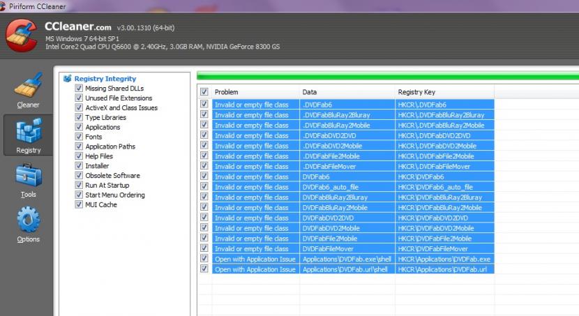

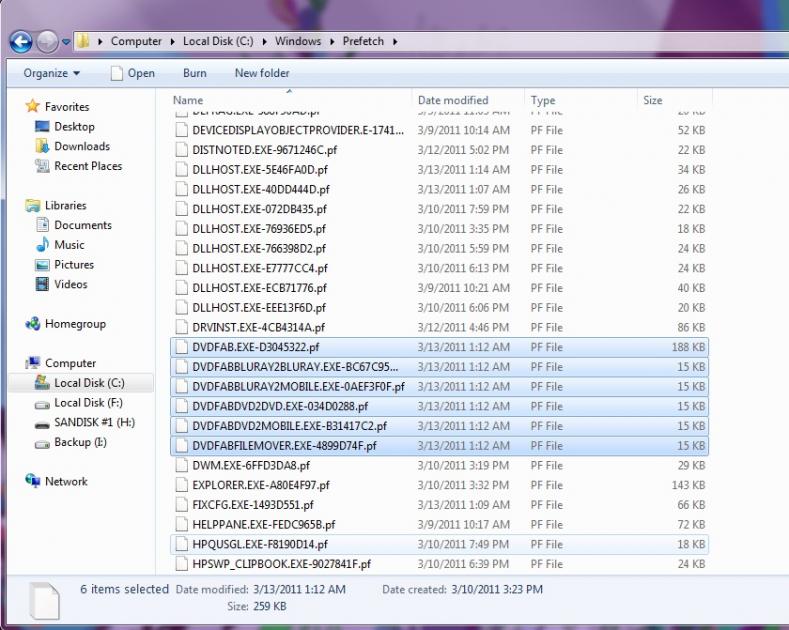

          Here is what I do. DVDFab is a great program but doesn't always clean up well after itself. I first go to C:\Windows\Prefetch and find all mentions of DVDFab, 8.0.7.9 left 6 files. (See Figure 1) Then I use CCleaner and scan the registry, again several entries were left behind (see Figure 2). If you have never scanned the registry you'll need to do this until no issues are found, sometimes three times or more are needed. This has never caused a problem on my system with any software.
          This should not affect your DVDFab registration but as always keep your key safe. And you will have to reenter your preferences.
